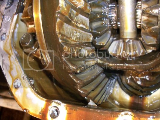

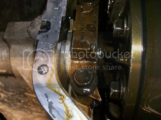

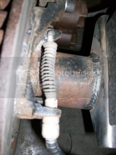

It all started with a howling rear end, and a front diff that looked like this when I pulled the cover off.

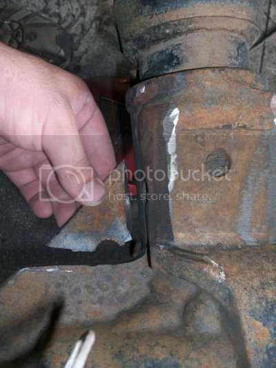

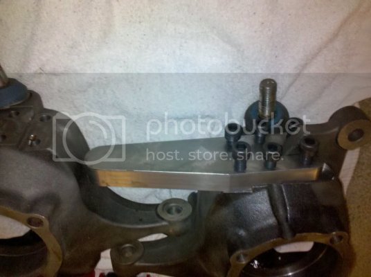

I picked up a set of 2003 F-350 axles locally: a D60 front and a Sterling 10.5" rear. I was also lucky enough to get the drive shafts.

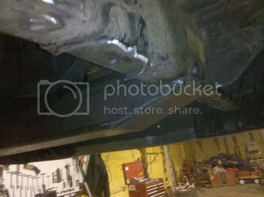

I then notched and massaged the driver side perch for a bracket I made. This would allow me to link it, with out having to weld to the cast.

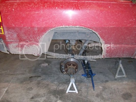

My attention then turned towards the rear. I got the Sterling hung with very little fuss. I was able to hook up the e-brake just like it came off my 9.25" factory rear. I also hooked up the brake lines with the use of 2 adapters and a 12" hose.

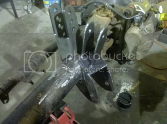

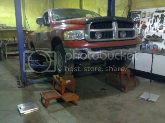

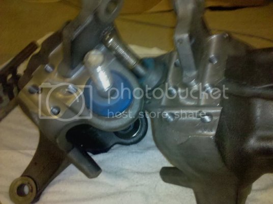

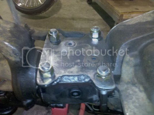

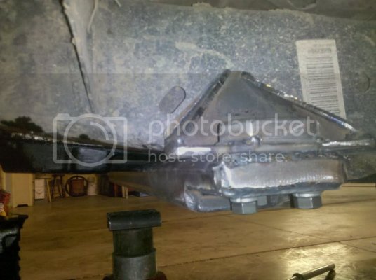

Once I took it for a test drive on the IFS and the Sterling rear, I was satisfied. I then started working on the front axle. Here are a few pics of the U-bolted bracket I built.

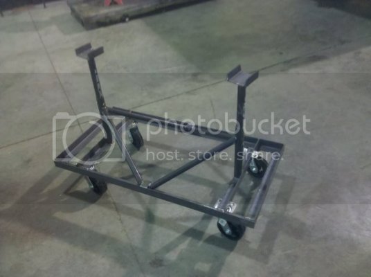

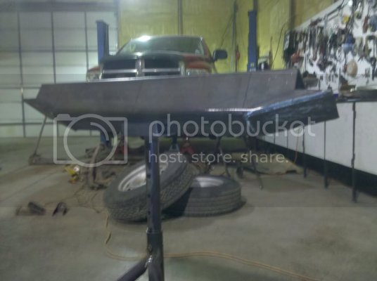

Then it was time to tear out the IFS. I built a frame stand to roll the truck around. It has come inn VERY handy.
Once I did that, it was on to designing the placement of the front suspension components. To do this, I first needed to figure out my center of gravity. That was crucial information I had to plug into the 3-link calculator.

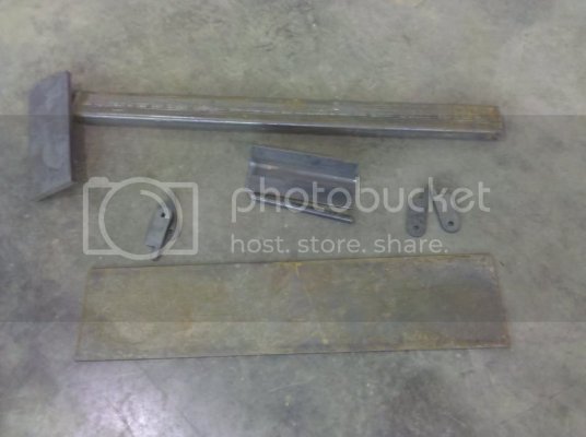

After I had the numbers, I started using the the blue tip wrench.

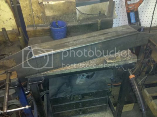

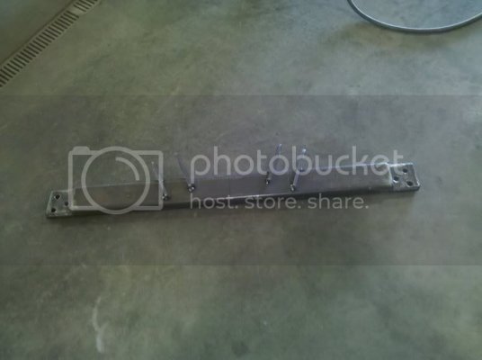

I then built a cross member to replace the lower control arm (LCA) cross member that needed to come out.

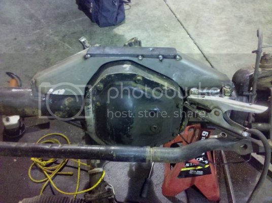

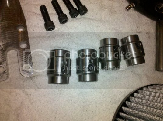

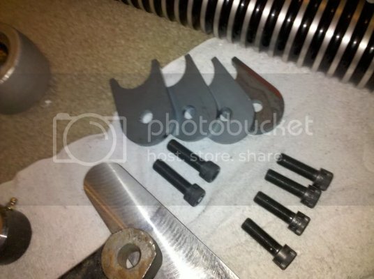

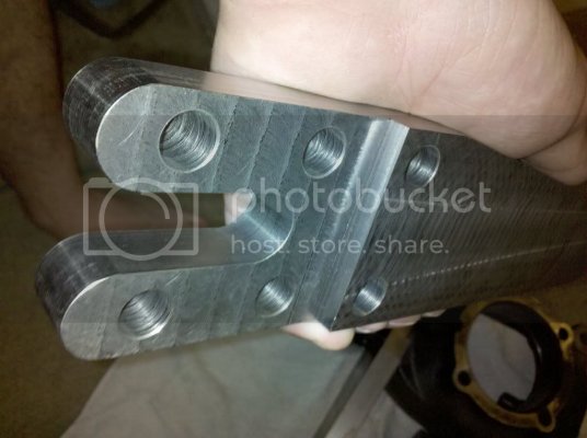

I then ordered a few joints so I could start build brackets and tabs for them to mount to. That also included a truss for a 1979 D60 that I massaged to fit the 2003 D60.
I would eventually turn this pile of steel into a cross member.
