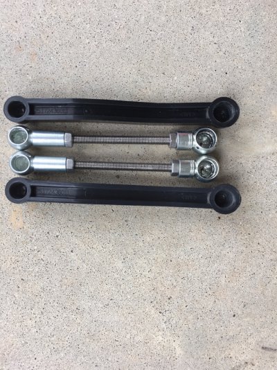

Attached is a pic of the linkages I used to level it out. This was taken before I installed them and the length difference is even less than what’s in this pic. As they were adjusted once on. Sure hope they don’t try to blame both sides collapsing at the same time on a $20 part. 7ec3c1b27e9c236b5bf2c68119b72c07.jpg

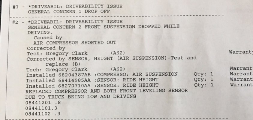

Got truck back today. Work order shows compressor shorted. They replaced the front height sensors and put the oem plastic linkages on. Guess they kept or tossed my adjustable links. But hey, they covered it all under warranty. Real question is what caused the compressor to short out? Just normal failure or some underlying issue?

Only thing I am worried about is I put the adjustable links for the height sensors on it like 18 months ago. Not sure how this could cause a collapse though. They are still connected and look fine. The length difference between the factory links and the adjustable ones are like 1/8” and they hold no load. Just used to let the sensor know the height.

If the aftermarket links were shorter than the original, it would seem to me that the sensors would be continually calling for air. If that is the case, the compressor might have overheated. I hope someone really up to speed on this system will chime in. That's really good that the dealer made all that happen under the warranty.
I would say not likely as it is only raising up a little bit. You can run in Offroad 1 and Offroad 2 heights that are a lot higher than this. Members and other users have been running with these linkages for years. I think either it was a fluke or I have something electrical going on. In the almost 2 years I've had the truck I've to have the front locker motor replaced, wiper motor replaced and now the compressor due to shorting.
If I put my truck in Offroad1 or 2 and start to drive down the road, the truck will reset to normal height, all by itself. I haven't investigated at what speed that occurs, but it is pretty slow. The problem of being higher than normal ride height is that it is not at a known different ride height, (OR1,2), so the sensor, I think, would call for air. That's still a guess, though.
