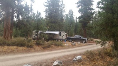

I tow this trailer which is 31'6" from ball to bumper, and it weighs just at 6378 Empty, with two 6 volt batts, two full 40lb LP, and all the crap my wife and I put into it, plus 66 gallons of fresh water, I am sitting right at 7346lb. My 2016 1500 QCSB 4x4 5.7 3.21, pulls it just fine. I have a really really nice WD hitch with built in sway control, and With it all set up properly, I can pull it down the road at 65mph, with no problems. Sway is minimum, even with southern Idaho winds.
Yeah going up hill, isn't the most fun, but I dont tow a trailer every day. If I did I would have a 3500 6.7. With what I need, and what I do, it works just fine.
Comparing a 1500 5.7 to a 2500 or 3500 6.7 CTD is assinine. OF COURSE the 6.7 pulls night and day different, its designed for that.
