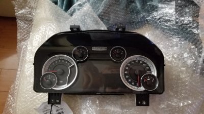

Just got my premium cluster. I paid $175.00 shipped. It's going out tomorrow to be programmed. When the guy gets ready to program it he's going to call me to get my actual mileage, run and idle time and then add about 50 miles to it so I can drive my truck up to the programmed mileage and then swap it out. I can't wait to get it installed.

Wow! Surprised he'd accept your word on the mileage over the phone without some sort of backup. Such as a cell phone pic, actually driving the vehicle to him....
It's a common practice. The only folks who are legally required to document this are dealers and sellers if there is a deviation.
He requires a "mileage Affidavit" to be filled out with your name, address, mileage on current vehicle, requested mileage etc, etc. I need to drive my truck while the gauges are out being programmed. I can go a day or two without driving my truck so I asked him to call me so I can get it exact for when I do the swap.
