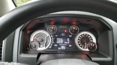

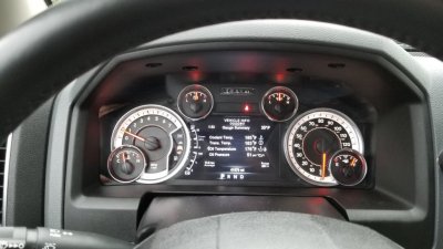

Hello,
Here's the update on my cluster upgrade.
My gauge cluster got to Dominic on Wednesday and was on it's way back Thursday morning. It arrived Saturday. I had him program 75 miles more that my vehicle's current mileage. So today I hit the programmed mileage and swapped it out. The neighbors must have been wondering what I was doing driving up and down the street a dozen times as I tried to get the mileage exact. LOL
The swap went smoothly, actually it was very easy. I've got to say, for the money and ease of installation this has to be the best upgrade you can do to your truck. The new display is simply amazing and has a lot of customizable information. I paid $175.00 which included shipping, for the Premium Gauge Cluster. $27.00 to ship it to Dominic and $150.00 for the programming. So all told I'm into it for $352.00. I think that's pretty good
Everything works, all menus function and there were no fault codes.
I've attached pictures of some of the menus but all menus and setting options work.
20171212_135349.jpg 20171212_135352.jpg 20171212_135355.jpg 20171212_135403.jpg
