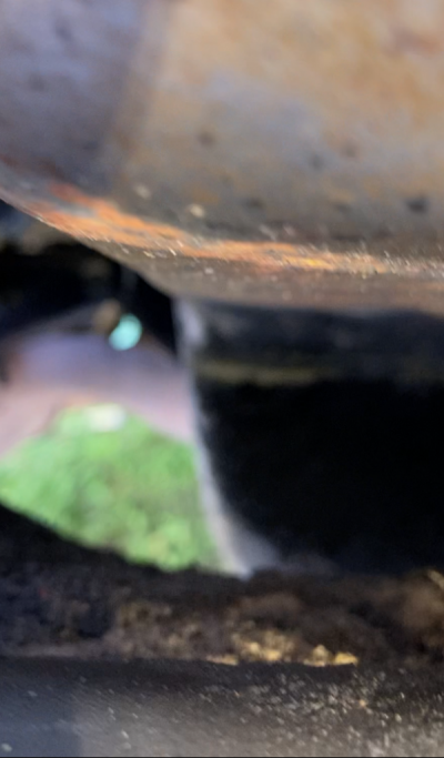

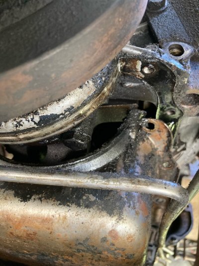

Has anyone removed the oil pan with the engine in the truck?
Some say remove the engine mount nuts, place a jack with a 2x4 under the harmonic balancer and raise the engine 2-4 inches. Sounds good and looks like it may work, when replacing the engine mounts the engine did raise a good 4 inches.
The goal is to replace the oil pan gaskets and seals, most likely the oil pump too since cleaning the pickup screen is a must.
crossmember clearance (2).pngoil pan to crossmember clearanceoil pan bolts etc (2).pngoil pan bolts passenger side
Any thoughts, recommendations and comments appreciated.

removed the oil pan without raising the engine, but the front counterweights on crankshaft may be in the wrong position
after turning the crankshaft the oil pan literally fell out
