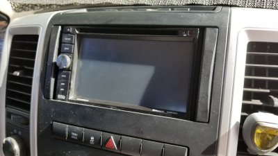

https://www.crutchfield.com/p_104BN965BL/.html
I put this Boss unit in my 2011. I specifically wanted something affordable 20200629_091137.jpg 20200629_091137.jpg with a backup camera, bluetooth and navigation which my truck didn't have. I used my existing speakers. I have been happy with it. I bought from Crutchfield because they have excellent customer support for installation and parts specific to vehicle.
Heads up though. After you remove the dash you will have to trim the steel frame to fit the unit in the opening. I think I would have had to do with any unit I would have bought. With bezel/trim it fits perfectly.
