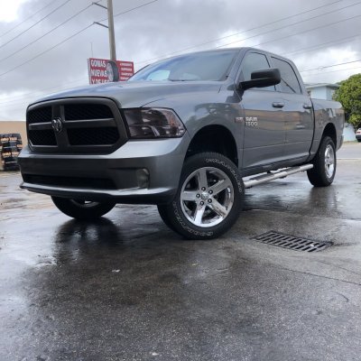

Well, settled on the 4.5”/3” Maxtrac lift! Super happy how it turned out. Installed in about a day, aligned the next morning. Now for wheels and tires. What have you guys that have this setup gone with?

WOW!! love how it turned out!!
my wheels are FUEL 20x10 with -18 offset
no rub anywhere & not too much hanging out of the fender
realy like the MOTO METAL also.....

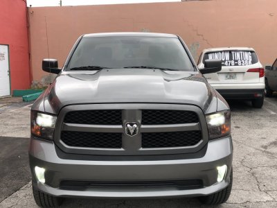

Front windows and wind shield tinted today. 20% to match the rear and 50% on the windshield. Loving the look of the XD Grenade in gloss black with 0 offset and the Fuel Rebel in black with +1 offset.
