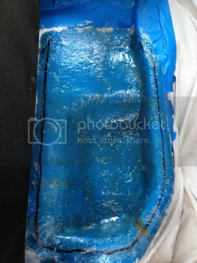

So on to more pics of the install and fiberglass. I only got one layer put down today.

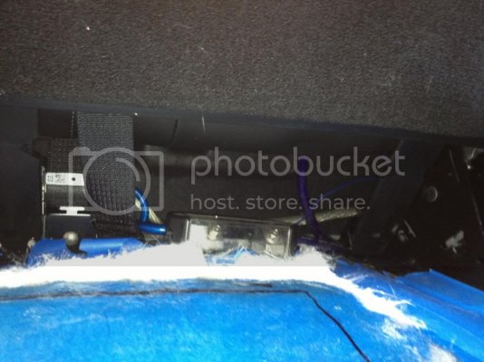

Power and Ground wires are set.

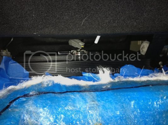

Amp is set.

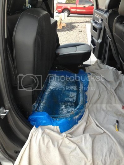

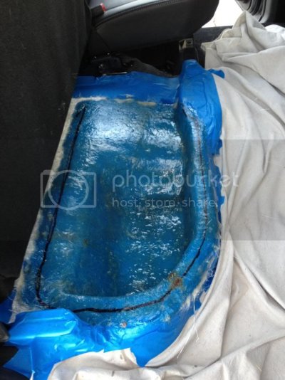

First layer of fiberglass in down and curing.

No, it won't be permanant. I put the blue painters tape down first to not ruin the carpeting, but it will help me remove it after it cures. The enclosure will be removable and all factory parts will be replaceable like it never happened.
So I just added about 3 more layers. I'll wait for that to cure for a while then I'll take it out of the truck and it'll have enough rigidity to keep its form and allow me to work on it outside of the truck.

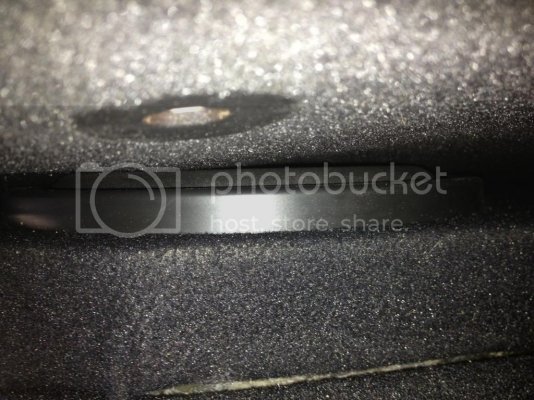

Update: I need some more materials that I couldn't get today since it is Sunday and the stores I need to go to are closed. Tomorrow, I will try to get those items and hopefully have the speaker installed by Wednesday.

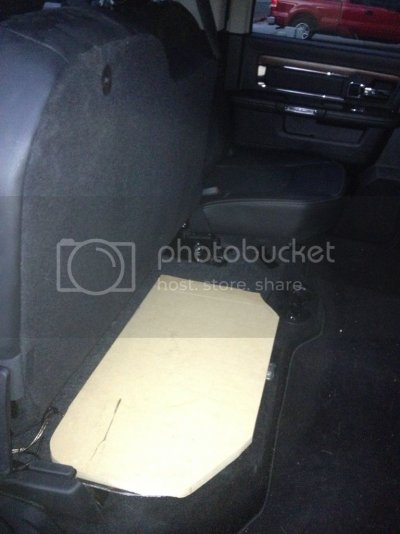

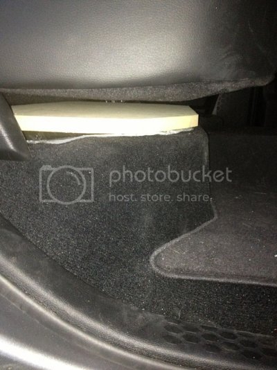

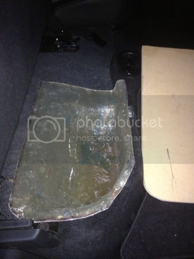

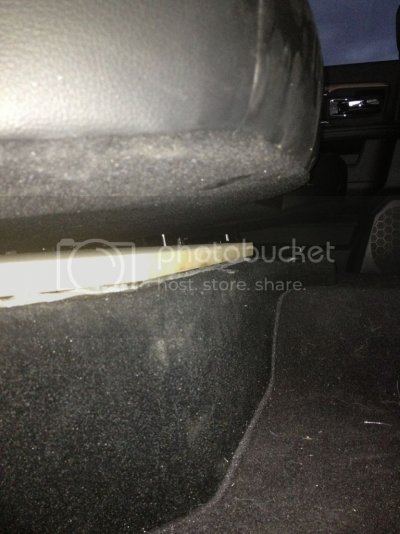

Pulled the base piece out and trimmed it to the size I wanted.
Cut a piece of 3/4" MDF to fit over it.
I still have some gaps to fill and that where the Kitty Hair (reinforced fiberglass/bondo) will come into play. Then some more touch up fiberglass work. Then comes sanding and minor touch ups and I should be ready to install the sub.
Still have some clearance room for the sub to move. Barely gonna make the minimum recommended sealed airspace that is required.

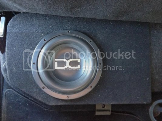

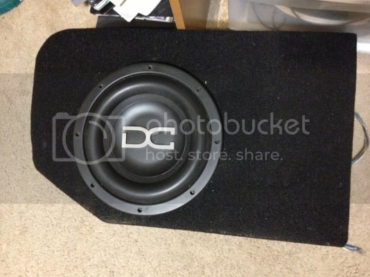

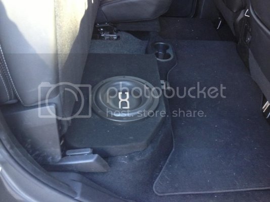

Finished product I'll have more pictures
