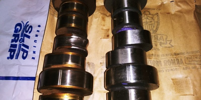

The one problem No Hemi owner wants and too many have already had the famous lifter roller seized and eat the cam lobe off yours2.jpg #3 mine was #6 as seen by the comparison of new cam in pic followed by three more close behind not shown in this pic
