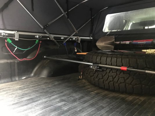

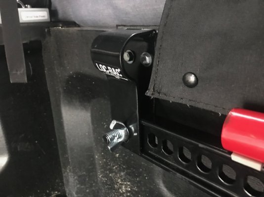

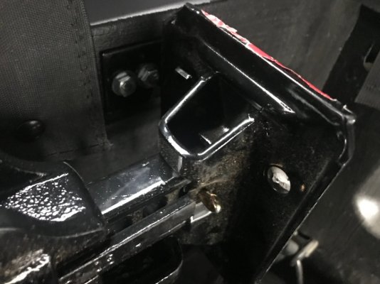

Here you go, i used the Hi lift Loc-Rac universal mount, drilled a couple of 1/4 holes in the bed, and secured with the provided bolts and nuts (i used 2 washers per bolt one small front, and a bigger one in the back to hold the nut off, washers are not included in the mount kit)
I spent a lot more time trying to install the nuts in the back of the bed. In my case i just put some tape around my finger after struggling with the first bolt, and that did the job 20 times easier as the nut will stick to the tape.

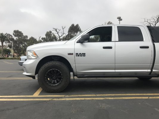

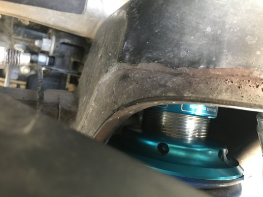

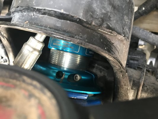

So this are the new King CO settings for 2.5" lift. The only difference between a bone stock truck and mine when it comes to weight is that i have rock sliders, a 100lbs full tire spare and extra 80-90lbs because of the Hi lift jack/shovel/Softoper etc.
I don't know how heavy are the rock sliders since i didn't check them out, @revitupmoto33 do you have any idea since you're the maker :) ?
Rear is now at 40 1/2" ground to fender.
Passenger side, 8 full turns from factory, 8 open threads
32631202317_dbe11688cf_h.jpgIMG_2988 by RAM RSM, on Flickr
Driver Side, 8 full turns from factory, 9 open threads (they add one more open thread gap i guess to compensate for driver lean)
47520763752_7eef9c0266_h.jpgIMG_2987 by RAM RSM, on Flickr
I didn't take a picture of the gap between the fender and the center hub, but with the Kings that's 26" (measured without the wheel, from the fender edge to the center of the hub nut)

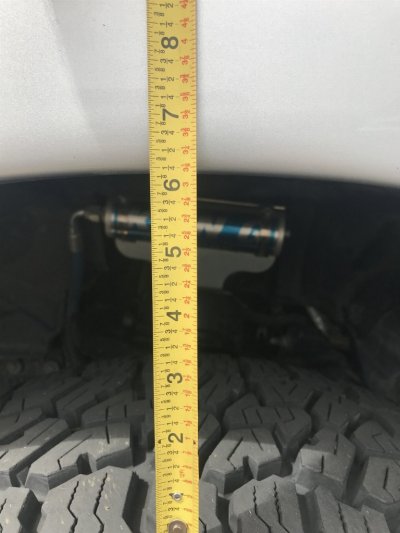

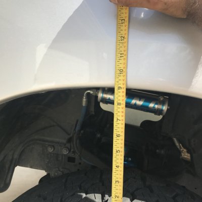

Max down travel with wheels in the air and 315 tires. measured from fender to tire edge: 9"
32631202907_843f68709a_h.jpgIMG_2986 by RAM RSM, on Flickr
With the truck level: 6 1/8
47573742561_15a016d83f_h.jpgIMG_2994 by RAM RSM, on Flickr

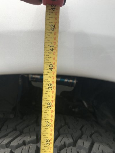

Total droop from level: pretty much 3"
Ground to fender edge: 39 1/2" (the angle of the pic appears to show 39 5/8)

I'll have her aligned again on Saturday.

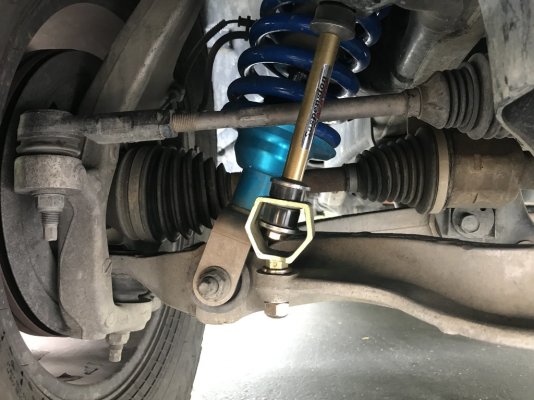

Suspension max sway bar links update, they started clicking while on the trail and it's basically the middle tube hitting the washers because the bushings are a little loose as the bushings will compress some when you put the suspension to its paces. i'll try tightening the nut up just a smidge and see if they stop clicking for good, but that's how i crushed the bushings the last time little by little, lol so i don't want to crank the nut up because eventually the bushings will compress some more anyways and the whole noise/tightening the nut up cycle will repeat.
They don't really bother me much as the noise is not super loud and it only happens when i hit potholes/speedbump and what not. Otherwise they're normal quiet, and i like how the truck handles with this ones so i won't bother much with them. The bushings are intact from the offroad trip this weekend so that's more than enough for me. They work for what i need them to do.
