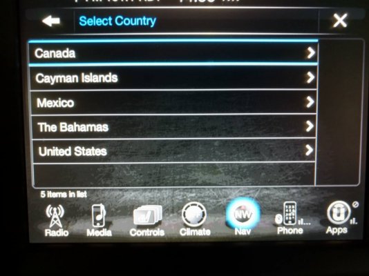

When I brought my truck to the dealership they stated that the gps won't work due to the US maps not being available on the unit. I called Sirius xm as to why I couldn't get that to work and they also stated because my radio is a Canadian unit
I'm willing to bet you can bring up this same screen on your radio..
The dealer is full of BS..the same goes for Sirius..

That option doesn't look familiar to me but I'll have to see if I can open it when I get back to my truck

I should have noted that menu is under: Where to? then by: Address
