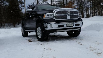

Here's my truck:
2" front level (I believe readylift)
1.5" rear level (I believe readylift)
3" PA Body Lift
Mevotech upper control arms
1.5" BORA Wheel Adaptors (equal to-12 offset)
Stock Longhorn wheels
325/60/20 Goodyear Duratracs
Airlift 1000 -needed when you lift. If you use the box or pull trailers you don't want that squat!

How long have your mevotech UCA been on? Any issues?
I've had them on for probably 12,000 kms now. They seem to be working well, my only complaint is the paint on them. They're completely rusted over so now I have to take them off this spring to be properly painted. Here's a pic of what they look like now.
