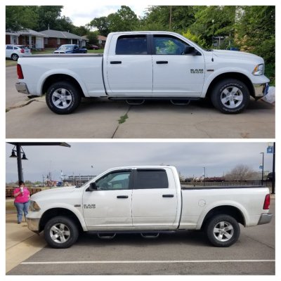

I have a 2016 and installed the RC 2.5" lift. Only went up one step on tires (285/70/17 - roughly 33")and still have plenty of room.
Top pic is stock (275/70/17)
