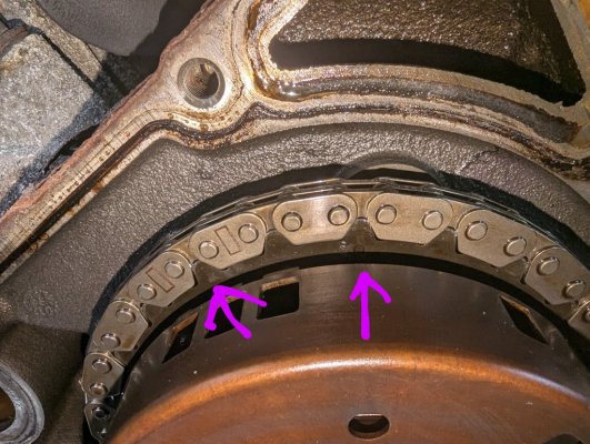

I have a 2015 5.7L that used to be a police truck. So it has some hours on it. It was running fine and then it all of a sudden had multiple cylinder misfires and a cam out of sync with crank code. Changed all the plugs and coils and put a new cam position sensor in. Cam code went away but still multi cylinder misfire. Pulled the timing cover after surfing the forums for awhile. When I lined up the timing marks at 12 for the cam and 5:45 for the crank, this is where the chain was.
I pulled off all the timing chain comps, checked the pin on the cam and looked over the parts. It all looked well enough. Put it all back together with the timing marks where they are all supposed to be. Turned it over a dozen times and timing marks never lined up again. This is where they are now. PXL_20241013_171328912~2.jpg
Is the Phaser shot? or am I missing something all together? Thanks all

If you set the timing right before you put the chain on ( #1 piston at tdc and and cam phaser mark a 12 o'clock) that is most important. If you put your chain on right with it set up this way you'll be fine. The marks on the chain will line up again but only after about forty full revolutions roughly. I know this can throw people off. You keep cranking it will eventually line up again.

Well that's good to know. SO then I should be good on timing and didn't need to spend the $300 on the timing kit. Now I'm really wondering what's causing the cylinder misfire.

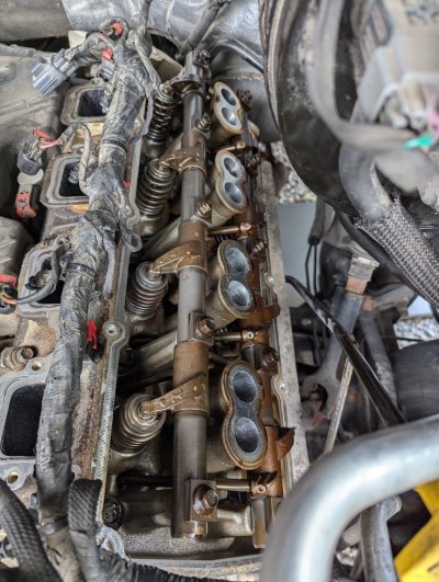

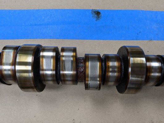

Pull the valve covers and intake manifold, and inspect the valve springs for any that are broken.
If no, rotate the engine with a socket on the harmonic balancer bolt and watch the valves. Check the range of motion and see if any rocker aren't moving, or aren't moving as far as they should.
Basically, check for broken valve springs and/or a flattened cam lobe.
Take a look at the VVT solenoid, for any metal shavings on the screens. If the "cam out of sync" code was the P0016, I believe that can be caused by a VVT solenoid that is bad, clogged or something. Also, look the VVT solenoid over real well and make sure it isn't some cheap aftermarket junk or counterfeit.

More or less the chain marks are irrelevant unless your rebuilding. I’m not serious… but don’t worry about them. Rotate the engine until cylinder one and cylinder six are top dead center. That insures the crank is in the correct orientation. The cam phaser mark at that point should be at 12 o clock. If it’s not then there is an issue. Timing these engines is very simple.

If it was a police ttruck that means it idled ALOT you 100% will hae a bad cam and lifters no question about that basically just expect it when you buy a police and or a fleet truck they never shut em off.

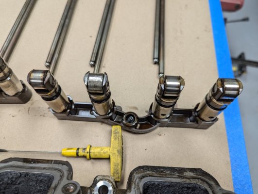

Agreed, if OP already had the phaser off he could pull the cam and check for worn out lobes. If on a serious budget, if only one lobe is damaged and the others are okay then he could get away with only pulling one head and replacing one cassette of lifters and the cam. Not the preferred way but can be done. OP lets us know your thoughts. We’re here to help.

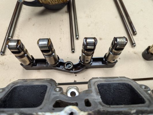

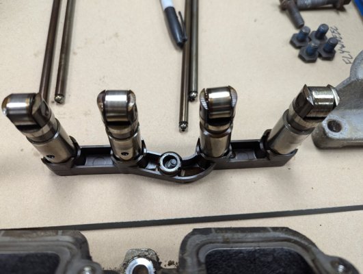

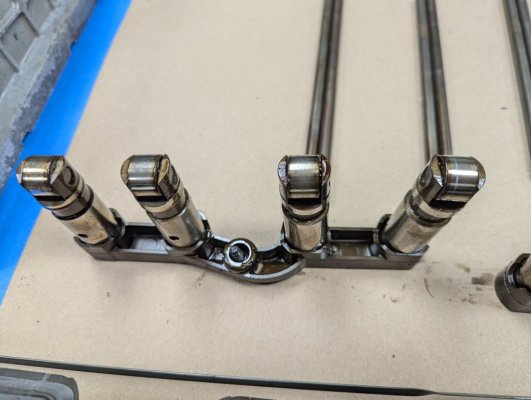

This should explain a good bit thus far. I've pulled the valve covers and don't see any broken springs. I am off to the store to get a small pen magnet, the one I have is a little too big to get the rollers out of the head. I'll then pull the cam. I shouldn't have to pull the heads off? Right? Please tell me I'm right? haha
Jan 17, 2016
23,721
54,483
14 Sport
You need a new cam and lifters ,so you're pulling the heads anyways,as you can't remove the lifters with the heads on.

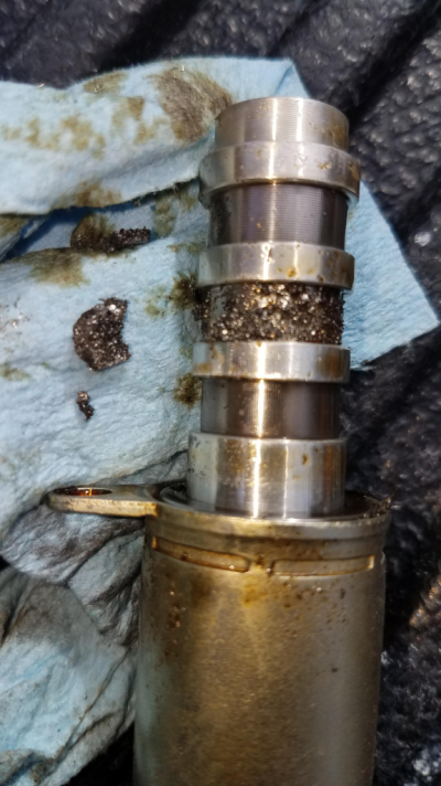

Generally Ma Mopar reconmends replacing the engine if the VVT solenoid is full of metal like yours is,but a few guys have got away with just replacing the cam and lifters and flushing out the engine,then doing several real short oil and filter change intervals after it's back together and running

Bummer!
If it were me, I'd pull the engine and either replace it, or rebuild it.
If you rebuild it, strip the block bare and go through it with a fine tooth comb to make sure ever single oil port, hole and galley is completely clear of metal flakes.

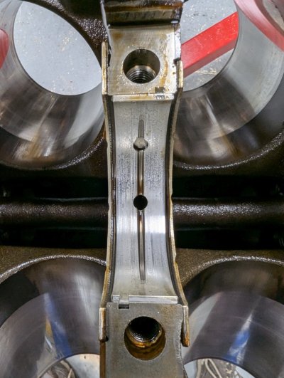

That kit would be good to go, IF you use the Mopar lifters and Mopar cam.
But, before you put another cam and lifters in, it's critical that the block be completely and thoroughly flushed of metal particles, or replaced. When metal is present on that vvt solenoid, it means that it made it into the oil galleys.
Read post #9 for an indication of what happens if you leave even a little bit in the oil passages
