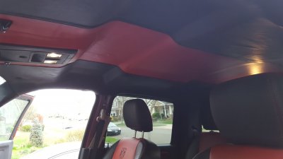

Like everybody else I can't understand why Dodge put tan colored interior from the pillars up so I aim to fix that!

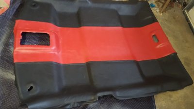

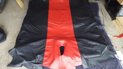

I just so happened ot have a large box of red and black leather I had bought for a hot rod a couple years ago that never got finished so I decided to use it on my truck.
I started by pulling ou the pain in the ass headliner. Had to remove all the seats and trim to squeeze it out the right rear door. It was tight but it came out. sewed the red and black leather together for a nice red racing strip down the middle lol That's the way I ordered my leather seat covers so it would look nice with the headliner

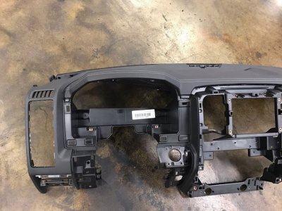

So local kid works at Dodge dealer. Someone smashed a bunch of windshields so insurance replaced th windshields and on most of the replaced the dash too because of a little dirt scuff.
So I scored a brand new leather stitched dash from him for $300 and swapped my plastic dash for the leather one. Looks pretty sweet. I was wishing I could find a REBEL dash with the red stitching but this is still way better than plastic

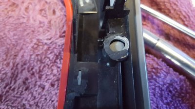

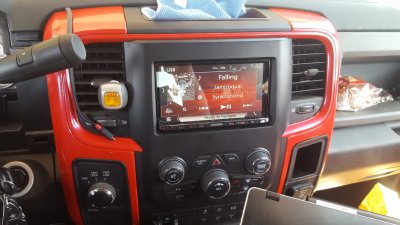

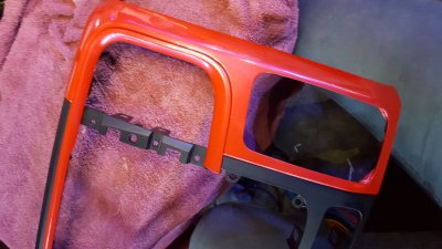

So next I started thinking I would vinyl wrap some of the dash pieces in red vinyl. The question though is on the center bezel around hvac controls and radio you have both grey and black. SO I started looking at it and took it apart.
I realized the grey parts are plastic welded to the rest of the frame of the bezel.
Took a grinder and ground all those grey plastic bumps off and the pieces separated making it much easier to wrap them and get nice tight seams to contrast against the black.

Once I wrapped the red vinyl I went to hardware and store and got some screws that were the right diameter and very short like 3\8 long and screwed them into those gray posts that I grinded to separate the pieces. It worked perfect! It held the pieces back together nice and tight.
The finished result was nice looking seams between the red and black! Looks sweet
I have a couple little spots and defects but I think it looks pretty good considering. This was my first time doing any interior upholstery or vinyl wrapping so give me a break LOL

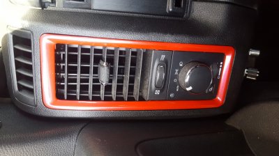

the air vents were even easier, they come apart very easily and wrapped those bezels too

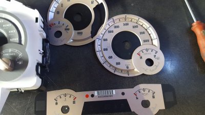

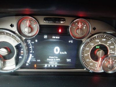

I've been driving with a longhorn speedo for a while because it was cheap because it was in KPH instead of MPH it was from Canada. Plus the gold trim did not go with the color of the interior very well.
Luckily US Speedo is now making replacement faces for the gauges. unfortunately they did not have red yet so I chose some silver ones so now my speedo shows MPH like its supposed to. I can't wait till they start making red ones.
