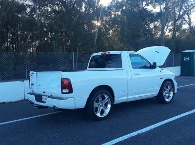

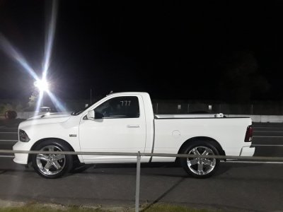

Well after chasing 12's for a yr now I finally got what I wanted. I have been battling the high speed wobble for a yr & finally fixed it w/ the Illicit brackets. Now I am able to make a full pass & stay in it instead of letting out if it to steady the rear. I'm very happy w/ the truck for being on the factory R/T 22" wheels/tires. The da tonight was -300. Sooner or later I will do a DSS driveshaft, lt's w/ catted y pipe & dr's. Til then I'm happy w/ a high 12 second dd truck on street tires. Lol
2016 Ram R/T. My mods are:
Performance:
-Jay Greene motor/trans tune via Diablo I2
-S&B intake
-Magnaflow 2.5"/3" y pipe in place of the factory crushed y pipe
-14" Magnaflow muffler
-clutch fan delete & 180* t-stat
Suspension:
-2/4 Belltech lowering kit
-Illicit No Cut brackets
-Hellwig rear sway bar & endlinks
-Airlift rear helper bags at 5 psi
-Spohn adjustable panhard
-Bilstein stock replacement 4600 front shocks
-Bilstein 5100 rear shocks(nonspecific to our trucks, spec'd as a replacement to Belltech Street Performers)
Track Prep:
-Pulled front sway bar
-Pulled center jump seat(swapped from plastic console to jump seat early on)
-Pulled spare
-Pulled tailgate
My vehicle number was 777 and it sure did turn out to be a good night. Lol
