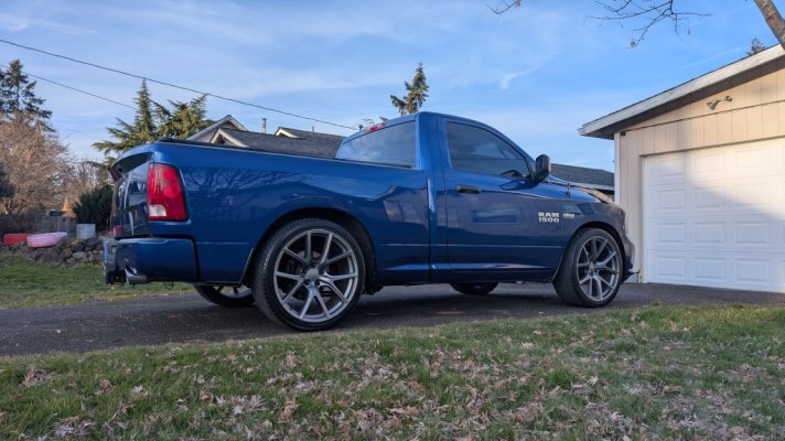

i drove it around a bit yesterday and it does ride a lot better, it only bottomed out once but it was on a really nasty dip/bump like when they are working on a highway and i also had a passenger and the rears were at 4 i believe
i do think its a lot better now, i just need to make sure the pinion angle is where its supposed to be and not eye balled.
but i did get it up to 90/100 and it wasn't vibrating.

100% the brackets moved it too far back, it was too far forward before the brackets, and too far back with them.
the adjustable arms pulled it closer to being centered, it looks basically like wild one's red truck.
i'm going to keep driving it, i think its pretty good but its no Cadillac lol

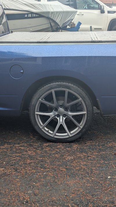

Looking good. Takes some 10 to 15 foot dead one side shots of the rear wheels on both passenger and driver side, then take a low shot of the rear end dead center.
Want to see if it's settled

it looks pretty centered now, depending on the angle you look at it it looks perfect or like 1/4 inch too far back so i'm pretty happy with it. its stiff but i'm happy with the ride now

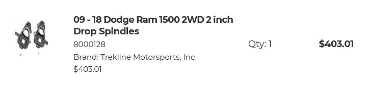

anyone know where to get some OEM front springs? i bought some lowering spindles and need some oem springs. when i bought the truck it already had the lowering springs on it.
whenever i look up some they always say they are for 4wd i dont know if they interchange
I'd contact Benny @AllMoparParts.com the forum vendor. Give him your VIN and he'll hook you up

They don't interchange,the 4X4's use a strut and spring. Did you check your local marketplace / craigslist / local wreckers etc, you might find somebody wrecking a truck,or who's put a lowering kit on,and is selling their original springs
