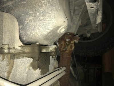

Back last summer I bought a new ram 1500, noticed 3000 miles in I had a transmission oil leak on my shop floor, took it to the dealer for it to be looked at, anyway long story short 3/4 of the oil leaked out of the transmission also resulting in some choppy shifting. Took it in, they said the fitting on the trans cooler was leaking from the factory and I likely ran a few thousand miles with very little oil. I asked if their was possible damage and the service manager said don't worry about we fixed the leak and put new oil in there will be no damage possible.
Fast forward to today, I did my first oil change myself given I am fed up with local dealers answer to my possible damage question. took a look at where the transmission case meets the engine and noticed some trans oil there sitting on the surface see attached pic, is this normal on a new truck with 10k miles? No dip stick of course to check oil level, another pet peeve on mine on RAM. I am wondering if the main seal is damaged, might explain the weird noises too before bringing it to the dealer.

There should never be transmission fluid on the case...even more so at 10k miles. I'd take lots of pics, and continue to take it in. Keep taking it in until it's fixed.

If its not the front seal in the trans I would say rear main seal in the motor. Take it the dealership regardless because it shouldn't leak anything.

no damage running with low tranny fluid yeah sure and after your warranty is up and it fails mmm I would be trying to get new transmission yep.
