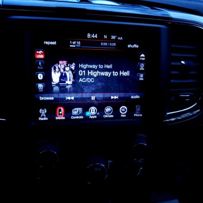

This is a fairly old post but I wanted to input my success here with how to get the album art and in album information to come up on my truck radio. I'm using a 128 gig USB, formatted using NTSF. I use Switch Plus NHC software to convert all audio files to WMA. MP3 may work, but I prefer WMA for sound quality even though the WMA files are larger. After converting all files to WMA, I use Mp3tag v3.11 to get the album song title and artist name as well as the album art to show up on the screen. This has worked with every album I saved on the usb stick. It did take some trial and error... but once you play around with this software it works great. The key also is once you convert your files, you have to hit save them. If anyone needs some help, hit me up and I can get you some more detailed info on how to do this.
