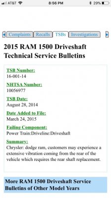

A few weeks ago there was a thread on here about vibration issues that were manifesting themselves more in the seats and floorboards versus the the steering wheel. Somebody will chime in that remembers better than me, but it was a batch of bad/unbalanced driveshafts, there may have been a specific range of VIN’s it affected, but the back story to that OP was very similar to what you were describing above.

Im searching for it now, but it was 2-3 weeks ago..I believe it was covered by FCA. That OP had the issue, bougt new wheels/tires at least once too.

The above may or may not be what I was looking for...but it allegedly affects more years...also could be movement at the transfer case...not trying to give you a bunch of white rabbits to chase, but it struck me as similar

Any info is good il look into the drive shaft tsb. I plan on getting the tires road force balanced in the next couple weeks. Any suggestions on were to go. I live in western ny.
