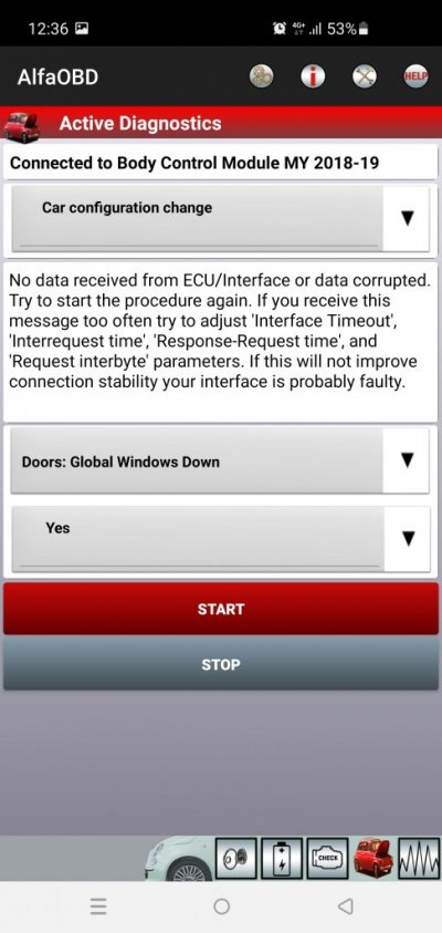

Hi,
I have Ram 1500 manufactured in December 2017 as per the tag When I connect to Body Computer in Alpha OBD, it connects to Module MY 2018-2019. When I try to make any change, it says "no data received from ECU/Interface..." (see screenshots attached)
Does it mean that I need to purchase the bypass module to have these changes done? Will it work only with this module?
