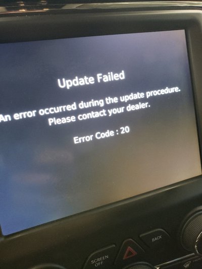

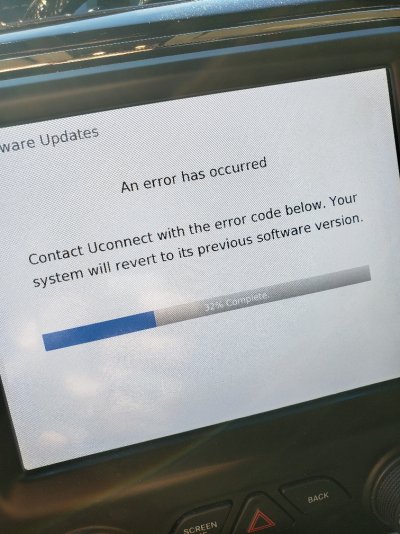

All, just wanted to know if this was related. Truck said it needed any update and to schedule it. I told it to do it and then it bricked with error code 20. I pulled the battery cables and it's now reverting to previous software version.
I'm just wondering if I should have pulled the security bypass thing before it updated.

I would only install bypass to complete the changes you cannot make without it and remove so no one can hack your system
You should not need the cable to do regular updates
2018 2500
Still waiting for the finish.
This Error 20 is completely unrelated to the OBD Bypass and is happening with a lot of the OTA Radio updates lately that FCA/Stellantis is forcing on to people (I have seen 10 or more posted in the last 2 weeks) ....
The radio is likely DOA and will need to be replaced under warranty, Contact member "RAMCARES" by private message and/or uConnect since they pushed the bad update down. Just for info sake... Is your radio a factory installed 2018 UAQ/UAS 4c radio or a 2013-17 RA3/RA4 that you transplanted?

Radio is original. It did boot up ok after recovery but stuff is missing like satellite and backup button doesn't work. I called the dealer, they said new radio as well...
I've got a good dealer, they'll get it taken care of.
The 2018/classic UAQ and UAS 4c radios take a few key cycles to reconfigure/read the truck BCM configuration and re-enable the SXM and BuCam after a radio reset (Sw update). They will likely be back working in the morning... If the radio does reset/recovers from the error 20 code ... Yours will be the first I've heard of... Although they should be able to revert if the update fails of left alone after 3 failed update attempts supposedly.
You can see other members posts about the radio update/error 20 code issue here ...

Radio working normally in the morning. I guess it recovered. It did not do the update. Didn't loose my radio presets or anything. Skipped going to the dealer.
If it wants to update again I'll try to say no..
