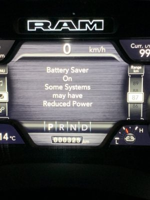

Having the same issue. Our dealer let's us take trucks over night or weekends before buying. When I took it overnight the remote start didn't work right. Having had a 1500 before I know if the battery is too low voltage the remote start won't work. The lights will flash only once like if you tried it with the door open.
Since I bought the truck 3 weeks ago I've had Battery Save Mode come on about 10 times. I took it to the dealer and the scan said there were 17 codes for low voltage and they said the battery is good, cleared the codes and figure the low battery codes were from the stop and goes moving it around the lot (it's been on the lot since April).
So today it happened again, when I got to work I turned everything off then the truck. Then I put it into acc. and went to the voltage screen. Within a minute it went from 12.3V to 11.8V. I think the battery is toast. It's going to the dealer again tomorrow. So frustrating I only have 325kms on the truck. 6.4L Snow chief group 8.4screen

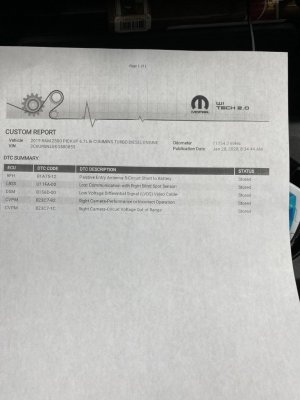

Still no fix. Just left dealer and they contacted Ram who said there is no fix yet but noted to not replace the computer/radio because that is not the fix. Very frustrating for a vehicle that has under 12k miles. Will post pictures of customer report diagnosis
I am very sorry to hear this, MegaCabDon. Please do not hesitate to follow up with us via PM. We would be more than happy to get this documented and connect you with a case manager for further support with this matter.
