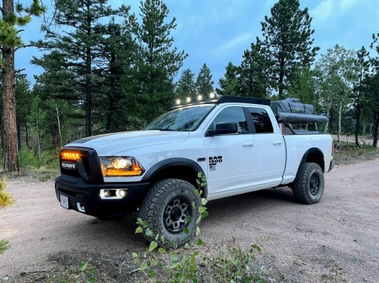

I've been busy working on the truck and using it the last month.
Took a wheeling trip to the Idaho Springs area in Colorado.

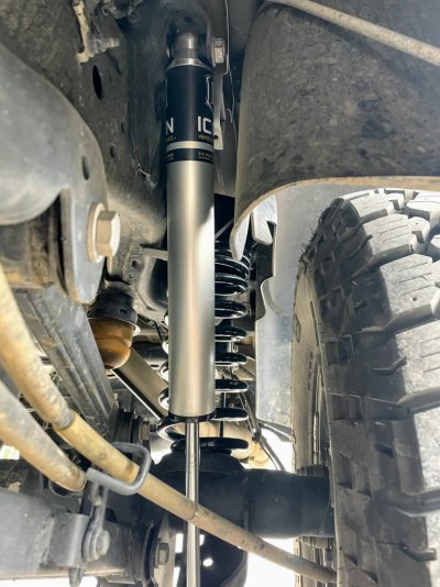

Truck did absolutely great on that trip. However Glamping tends to add a lot of weight. So the rear suspension is getting an upgrade. I have Superlift Sl-140 springs that will be paired with some Icon shocks. We'll try that in the rear for our upcoming trip next week.
Also have been working hard in the shop making products.

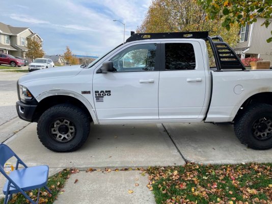

Bed Racks are done, Was going to go bronze to match the wheels....but it looked really bad on the truck so going back to black.
Installed a hooke road roof rack. I searched and it seemed this was one of the only roof racks available for the quad cab. The install rough. The quality of the fitment was not great. Also drilling out the holes on the rood was not fun. Oh well its done and it does look good.
Hope Superlift have redesigned their springs. Check the blogs in my built thread regarding those coils.
I think i read you got them dirt cheap ? so give them a try and see if the do the trick for you. When i did them they were not able to hold much more weight compared to the stockers. If you read on my build thread i had a lot of expectations on those coils cause i wanted to run longer rear shocks and their length came very handy. I only had 300lbs of weight back then and i swear of god i lost all 2" in literally 2 weeks after install. They're super long but they will sag just under your RTT rack below to what you have in no time after the install. And they're so long it would be a bad idea to add 1" spacers to gain 1" back.
@hodge-xj had the same results , i returned my set within a month. This was back in 2019 so who knows if they have had a chance to revise springs rates.

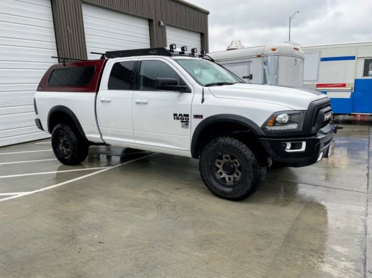

I've been looking at that rack. Would you buy it again?
BTW I consider that area home turf. Spent most of my formative years in Caribou, Lots of time on Switzerland trail, and time around the mines in central city and of course Oh My God Rd. The in laws had a cabin up behind Idaho springs on Soda Creek. So we've spent time on Barbour Forks.
great fun, beautiful area.
It was really beautiful! we did the Oh my God road and loved it.
As far as the Hooke Road roof rack goes The quality is fairly good, not Prinsu quality but also alot cheaper. The lights that come with it work and seem passable. You will have to get a wiring kit for it though. It comes with 6mm nutserts for installation If I had it to do over I would have put a little larger ones in there. It's sturdy though. I stood on it and it handled my 220 lbs just fine. For the price I would buy it again.

One of my good friends works for truck hero/Superlift. So they we're pretty much free. I was also able to get them within 2 days so Why not? Luckily I don't keep weight in it consistently. so maybe they wont sag.... If they do I'll go JT springs. The rear end of these trucks are so easy to work on I had the springs and shocks changed in about 45 min. I would however love to punch whoever designed the flares/fender liner. That took longer to deal with than the install. Cleaned up the backside of the flares while I had them off, that was much needed. The Thuren shock nut set was a wonderful decision. Thanks!
I will say with the new Springs and Icon Shocks the rear of the truck rides fantastic. it really smoothed out the ride. I took it on a good pothole ridden road after the install. What used to literally jumped the back of the truck around now doesn't even move. If 2.0's ride this good I can't imagine how well 2.5's do.
I'm not sure if the stock shocks are that crap from the factory or I wore them out already in 30,000 miles. But I could compress them with ease using one hand.... Icon's not at all.

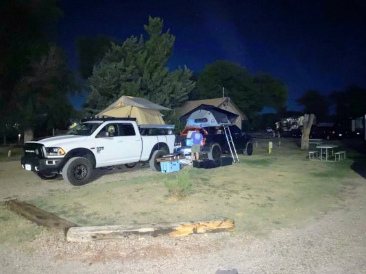

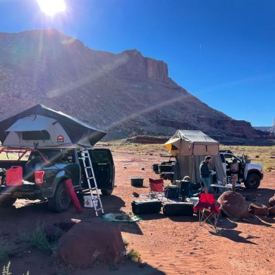

Trip Update and Pictures
We did a 6 day trip to Moab/Colorado. The RAM is getting more and more dialed for how we use it. The new Rear set up worked flawlessly on the trip. The springs handled all the weight well. With the full load she still had a slight rake which was a vast improvement over last time. The 2.0 Shocks from Icon really held up well to the abuse. We did multiple trails throughout the 2 states. handled it all with ease. Highway driving also we greatly improved. I was able to run 80+ with no problems at all. This was a vast improvement over the last trip where anything over 75 was a death grip if a semi passed.
The front will be next for an upgrade. The 5100's are doing well, and in theory would be plenty for my needs. However I got a little taste for some speed through the sand, and now I wanna go fast! Watching built SxS's blast through the trail at 50+ mph made me wanna do it too. :Big Laugh: So I think some 2.5 Front coilovers are next. My only problem is I want something in the 2.75-3in front lift range. I like having the articulation ability when playing on the rocks. I was very nice being able to stuff the tires at full lock and have no rub. So will see what happens there. As of now Icon is my first choice.
More underbody protection is also on the future list. I did manage to nail the T-Case skid while in moab.
This is a little PSA to all of you out there who do this kind of stuff in Grizzly Territory. Don't bring your dogs! We had set up camp at a great little spot in the Rampart Range area of Colorado Springs. We're all having a great time doing all the camp stuff, when a bear decided to just walk right in our campsite. He came within about 4ft of us. We threw the dogs in the truck and made ourselves very large. By the grace of God he turned around and got out of camp. We promptly packed up and got out of that area. I did manage to snag a picture unknowing with the bear in it. He came onto the road and to our tree line in the picture to give a reference of how close.

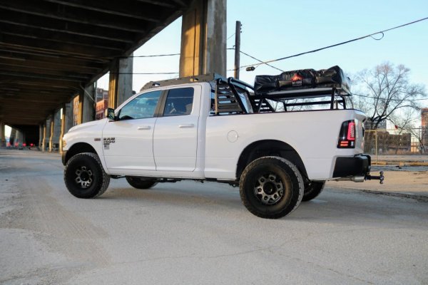

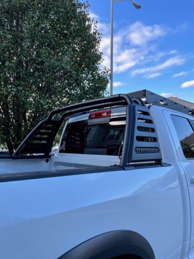

A little update for my records.
Scored a fantastic deal on a camper shell that came off of 3500 Dually. It bolted right up perfectly. However that same day my dog decided to be a ****** and eat a bunch of wood we had laying around. So with a very hefty Vet bill I just decided to flip the shell.
Fast Forward a little bit, picked up a used Rambar off of a TRX and it fits on the 4th gen/5th Gen HD 6.4 bed.... Not without a little cutting though. Had to remove some spacers on the underside, and trim off a little of the tab that goes in the bed stake position. Quick work with a cut off wheel though.
There is still room to put the tent and rack on with the Rambar!

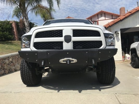

Well after almost 2 years and 40,000 miles later I got my first dent on the truck.... and sadly not the fun way off road. Some idiot decided to do a hit and run on me in a parking lot of a HyVee. Unfortunately Hyvee won't release any video footage unless requested by an insurance company. So Instead of spending the 500 deductible on the same bumper I'm going to build my own.
At this point I think I'm going to be doing a mix of the ADD bumper combined with @revitupmoto33 's bumper he built. Also I'm going to attempt a good winch mount somewhere in the mix. If anyone has any tips or tricks feel free to let me know!

How's the roof rack holding up? It's on my shortlist. Planning for March but I don't have any patience for anything...
Its holding up well! no rust and no movement thus far (I also put silicon on all the Nutserts - Probably a bad idea if I ever want to remove it.) The roof rack however has had as much impact on MPG's as the 35's. This truck has mostly highway miles so that may be a factor in that. From about 65mph and up the wind on the rack is felt.
