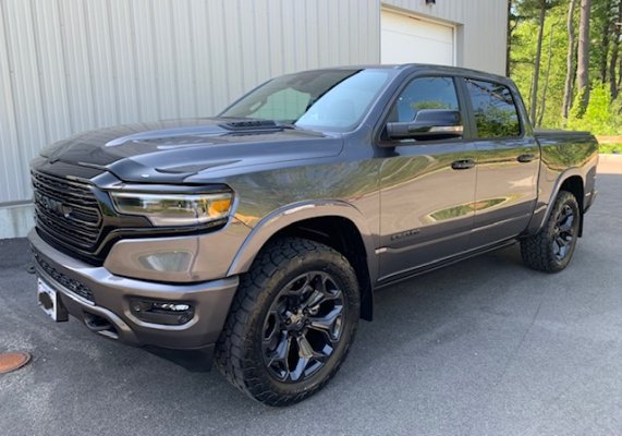

Hey Fellas -
I am running LT295/55R22 Toyo Open Country A/T IIIs (35X12.2) and I also have the Revel Link Leveling Kit and it rides great. I've never considered reprogramming my system for the new tires size...I have 3.92 gears which handle the heavier tire well as far as acceleration and shifting. I am new to the concept of reprogramming for a larger tire...what are the benefits other than a more accurate speedo readout?
