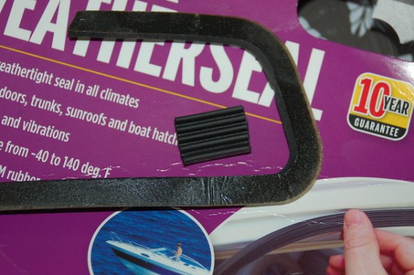

Go to your local home center and get a roll of marine grade weather strip 5/16 thick by 3/4 wide with an adhesive back, remove the light and replace the blown/shattered bulb clean all the old gasket off, put the weather strip on the lens with the seam to the side (NOT the top or bottom) Ideally the seam needs to be as small as possible, you'll have to press a little hard to get the screws to start, once started sock the screws down evenly and that's it, no messy silicone or RTV and it leaves the light easily serviceable

I think you meant 3/8 wide ? The previously recommended W/S that I used was 19/32 wide and 5/16 thick. I found it really put a lot of stress on the housing. see post # 13

Burla
Army
Apr 28, 2012
27,863
58,453
2010 Hemi Reg Cab 4x4
The marine rubber is so easy on and off, it wouldn't be a bad idea to do it every ten years. Let's be honest to why this happens, it happens because the OEM seal that will likely last forever, is thin and flat and not held tight as you can see it was just crimped in one spot, probably on original install the light crushed it. The OEM seal looked fine when I took it off my leaking light, it is just a badly engineered product. The marine rubber seal is properly engineered but yes fits tight. But it is adhesive on one side with 4 channels for protection, all 4 have to leak before seal fails, you would have better off watching grass grow then waiting for the seal to fail. Just one potential fix I haven't looked at others because it worked, still leak free whatever year it is now versus when I did the original one. I will probably do it again this summer, just to see what's up.
did you all have a crimp like mine right under sample mdf?
