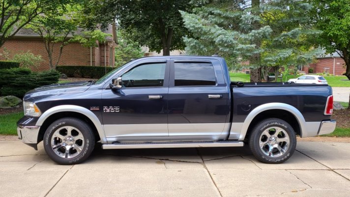

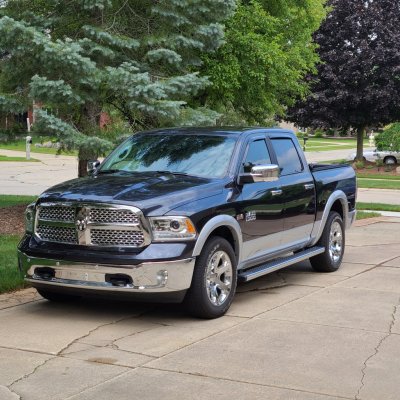

Hi guys, new here but have been lurking a while. I found this forum while waiting on my Bilstein 5100s (fronts still on backorder). Originally planned to level - but after studying pics of a lot of really nice rigs here I've decided to go for a 4" lift and 35's. (A 6" would be too high for my wife, kids and garage.) I plan to get a quote for the full setup from @Nick@GotExhaust. I can probably still cancel my Bilstiens if necessary. Looking for medium height and improved ride if possible, and leaning toward Zone or Superlift per several comments from the many knowledgeable members here. I don't do much off-roading, but do like the aggressive look of a lift. I definitely want to do something because I currently have a whopping 3" of rake! (Frt=33", RR=36")
I've read @brandonjansen's excellent leveling thread as well as several other great posts and comments from folks like @Quick_Shifter, and am curious to hear everyone's opinions on a few things:
1.) What are the big tradeoffs when going from stock radials to a good AT tire like a Toyo Open Country A/T III or Nitto Terra Grappler? Ride? Noise? MPG? Weight? Snow? Rain? I like the looks of the AT's but want to know what to expect.
2.) Am I correct that a 35x12.5R20 on my stock 20" wheels will give me an additional 21mm of width to the outside over my stock 275's (317mm - 275mm = 42mm total increase)? ...and if coupled with a 6mm hub spacer (if necessary), would create a total of 27mm additional tire-width to the outside? If so, this seems reasonable to me. I'd like some additional offset, but don't want to stick out past the Laramie flares.
3.) Should I wait for the Bilsteins and use them with a Zone 4" lift or should I consider something else? (I suppose that one may be a matter of how much I'm willing to spend on the shocks/lift, and what would be overkill for my use.)
4.) Will my 2-tone chrome-laden Laramie look wonky with a lift? I haven't run across any with my color scheme that are lifted. I'm mainly concerned about whether all the chrome will look out of place with a lift.
Thanks in advance for your input! I'm sure I'll have more questions later. :)

I think your truck would look great lifted, the two tone & chrome look sharp! I have been to Quick- Shifter’s shop several times, awesome guy & has incredible work ethic, he won’t steer you wrong. Brandon has lots of great write-ups, very knowledgeable concerning our trucks! Lots of great & helpful members on this forum, be sure to check out Nick @Gotexhaust a preferred vendor here.

Kudos to you for doing your research!!! You are pretty much spot on. Personally I skip the 4” all together. Our trucks love the 5” front 3” rear. Starting with a zone 6” lift the 5” can be achieved a few ways. I opted for amp research steps because they come down lower and make entry / exit a pleasure. For the tires I would not get hung up on the 35x12.5 I’m running a 325/60 which measures the same as a lot of 37x13.5’s. Everyone has their own preferences on what look they want, the more aggressive the rougher the ride. And the cheaper brands use harder rubber creating more noise. Toyo R/T is the most aggressive that I recommend. The AT3’s are what I run on my own truck. I’m happy to help you out with clearance for your garage etc. and I can lay out full kits if you’re purchasing from @Nick@GotExhaust (he’ll be the best price online, and his customer service is by far better than expected)

Thanks @Adamcr68, Nice looking truck! Thanks for the recommendations. I didn't know that @Quick_Shifter had a shop - it's too bad I don't live in PA.
@RJL1, Your truck looks great. Thanks for posting the picture - it does provide good reference for the factory chrome wheels, bumper and running boards with a lift. Will you be swapping the tires for size or winter performance? It didn't occur to me to ask how the AT tires perform in the snow. I don't have space to store a 2nd set so whatever I run has to do it all.
@Quick_Shifter, thanks for jumping in - and yes I'd would appreciate your help laying out a kit.
Regarding height: A 5" lift would cut it too close for me. My garage measures 83", my Ram is at 78" to the top of the antenna. With a 5" lift I would realize 3" additional height (both Frt/RR) and then approximately half of the remaining 2" front lift height at my antenna. 3 + (0.5 * 2) = 4". Add another inch from 35" tires and my truck won't fit inside. :(
Regarding tires, I dont have a preference whether metric or imperial but 35" looks "right" for my taste with a 4" lift. A 315/60R20 would be the same size if I understand correctly.
I am interested to understand the difference between shock options, and whether I should keep the Bilstiens or go another route.
Many thanks!
