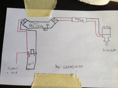

How about neither and run an hei setup. No ballast resistor, and super quick starts. I did this on my 79 truck and it works great. I have a diagram of how I wired everything somewhere. I'll find it for you.

This is the basic wiring for the HEI. I'll take pictures of how I remedied the ballast tomorrow.

I have the four terminal resistor. They had a two terminal at the parts store. I hooked tgefour terminal up and it wouldn't start it would only fire. Then I ran a 12 volt jumper wire to it and it started and ran good. Once I unhooked the wire it started missing out and ran rough. Then I looked at my diagram it showed a 1.2 ohm resistor which I haven't found. So I read about the accel superatock coil and it said it had a 1.4 ohm internal resistor so I unhooked my resistor and hooked that coil up and it ran for a lil while and it fried the coil. So I wasn't sure what resistor and coil I need to put on it so it will work like it should. I thought about that he I conversion I might do it if I can't figure this out so thanks for the diagram I'll hang onto that in case I go that route.
