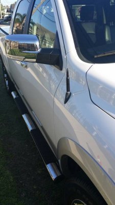

Looks cool, where did you pick it up from and how is your am/fm reception now?

Got it from Cravenspeed. I'll have to see about reception once I pick up my truck today... did this right before dropping it off to get painted. I only really use my ipod in the truck or the xm on occasion.

I'll check it out. Easy to replace? I tried to remove my antenna before I went into the car wash a few weeks ago and could not get that sucker off!

It's a bit of a ***** if you think you can just unscrew it... the chrome circle that has like 3 flat indentations is the part you need to unscrew first. After that's off you can lift it and unscrew the actual antenna

Oh, didn't know it screwed in twice. I couldn't get the indented cap off even with a pair of vise grips.

I used a flat head screwdriver to tap it loose then did it with the pliers

Keep us posted about the reception

Just as what seems to be consistent with the reviews of other stubby antennas I noticed a slight drop in reception today as I tested it out on the weaker stations but still seems fine. Easy enough to swap out if I go on a roadtrip.
