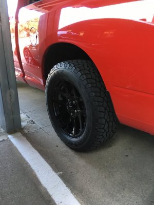

Trying new Cooper Zeon tires. They work great in the rain.
