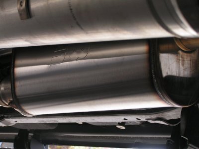

I put in a Magnaflow 3" single in/single out muffler & removed the resonator (gawd awful ugly thing sticking out behind the passenger side rear wheel) and I liked the sound.
Here's some pics and a vid:

Yeah...I believe it was the 12909. I remember it being 3" and offset/offset.
My Cummins was loud after the delete as all I had was a straight piped exhaust. I since added a Corsa 4" dB Performance Series muffler and it sounds just right. :)

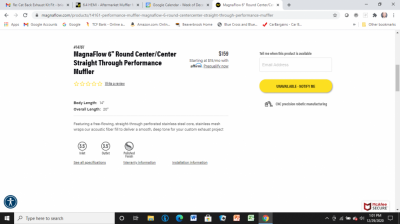

Did some more research. Borla and Corsa don't have loose muffler to swap.
Magnaflow, Flowmaster, Solo have some. I have no idea which might be better with all the vague marketing blather and video recordings. Below are published differences. Comments?
Solo - Mach 82, close fit, straight through perf tube (angled), rock wool & glass batting, 409 S.S., polished. $198.26
https://shop-solo-performance.com/en/mach-muffler-series/1618-mach-82.html
Flowmaster - 50 Series Heavy Duty, welded chamber baffles, no batting, 409 S.S., painted. $189.95
https://www.holley.com/products/exhaust/mufflers/street_chambered_mufflers/50_series_hd/parts/953558
(Note: short body, requires shim piping)
Flowmaster - 50 Series Big Block ...sim to Heavy Duty, except quieter, no shim pipe needed, but only available in painted aluminized steel. $199.95
https://www.holley.com/products/exh...ered_mufflers/50_series_big_block/parts/53553
Magnflow - 12909, close fit, straight through perf tube (angled), glass batting, 409 S.S., polished. $165
https://www.magnaflow.com/products/...eroffset-straight-through-performance-muffler
The Flowmaster people said acoustic batting is a 50 yr old 1st attempt at sound reduction that gets wet and loses attenuation, making those types of mufflers louder over time (Solo & Magnaflow). Muffler price is similar. Solo needs shim pipe. Flowmaster 50BB is closest to what I want, but not offered in S.S.
Which is best choice?
