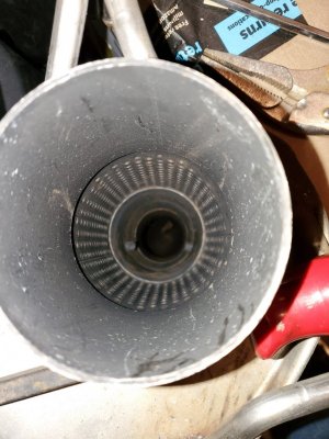

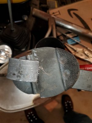

Since you're an engineer my recommendation would be to at least remove the flapper thingy (technical term) from the OEM muffler and see if that helps. Let me know if you need better pictures.Flapper1.jpg Flapper2.jpg

Yeah, I'm an engineer - I design things, and did some prototyping - I don't have a complete piping shop! I suspect digging out the flapper is a pain as well. Onward to headers.
So I ran an experiment and it takes precisely 5 good whacks with a pipe and a 5lb sledge to remove the flap. Took longer to make the 'flap removal tool' then it did to actually break the flap loose. I'm going to replace the muffler in my MF 19200 cat-back kit next week and see how it all sounds.
