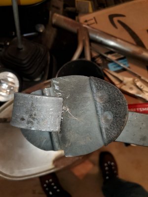

How did you remove the flapper? Can you detail what was used and how? Thanks in advance.
In my case it was a 2 step process. I used a piece of steel pipe and a handheld sledge to break the flap from the shaft. As mentioned, it only took a few good whacks before it broke off. However it was still wedged in the muffler so I wound up taking a piece of bar stock steel and folding one end over so I could slip it past the flap and retrieve it. You could really use any kind of hook here but the flap was stuck 8-9 inches into the muffler so you need something long to retrieve it. It was wedged pretty tight so in my case the bent bar stock worked best.
Again, here you can see it still stuck in the tool I made.
