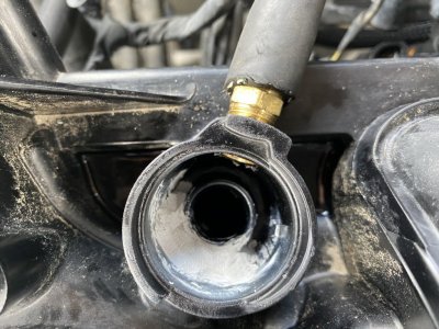

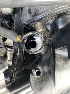

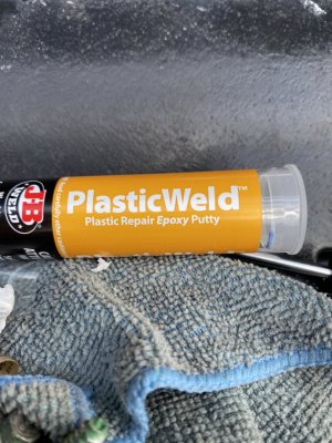

Finally had time to install the plastic weld to block the factory pcv vacuum port. Says 2-3 hours cure time. I used acetone to clean and prep the plastic. Make sure to remove the throttle body and reach your hand inside if you do this method so you can properly make sure the hole is filled and it’s a smooth finish on the inside of the manifold. Also helps you to check and see if you have any air gaps. I did so I ended up taking a pinch of the plastic weld and going from the inside and pushing it through the hole inside till it started pressing into the pcv valve housing.

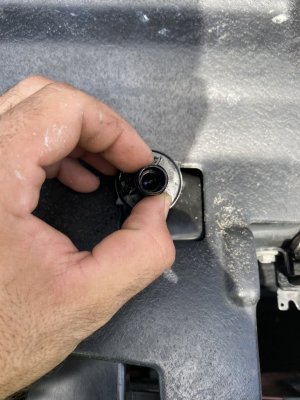

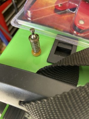

Alright guys. I am trying some other things for the pcv system. I feel the stock pcv valve is very restrictive and is very poor in design. I’ve gutted one of the 2 stock pcv valves that I have and added an in line one way check valve. I may purchase another and add it to the fresh air side as well to prevent the oil from traveling up that tube at reduced vacuum and force it through the vacuum side. Reason being as many know under hard acceleration vacuum is reduced drastically and the crank case pressure may exceed the vacuum and there is nothing on the fresh air side to prevent reverse flow. This valve has increased flow capabilities vs the stock pcv valve. I may reinstall an operational pcv valve and swap the check valve to the fresh air side. Not sure yet. More of a test to see what happens. Trying to see if it’s allowing to much air to bypass the throttle body.im sure the stock pcv was restricted to reduce airflow

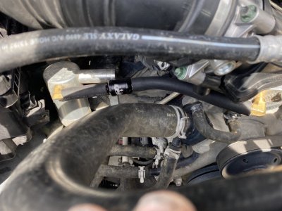

Well I’ve reinstalled the stock functioning pcv valve. This was drawing to much air through the crank case at idle. On my page is a video of the crank case vent with the functioning pcv valve and a video of the gutted pcv valve. I’m definitely going to add a restrictor valve on the fresh air side as well to prevent low pressure reverse airflow back into the Intake manifold. I’m leaving the restrictor valve that I installed in the vacuum side Hose as well as a secondary. This is the link to a video of all the hose routing for my catch can install. A few people on other pages are telling me that what I did to install the catch can is going to cause engine issues so I made a video describing the function of the pcv valve and how mine is connected to show them what I did as they don’t seem to understand what I have done properly.

I was debating running 2 cans. I’ve decided I’m going to run a Second restrictor valve in the fresh air side to prevent reverse flow. It’s a 5/8” tube size on the fresh air side.
