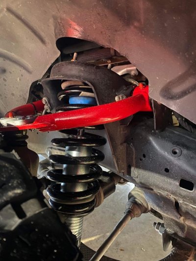

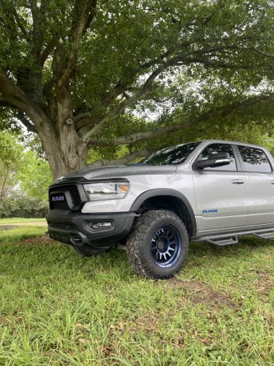

Picked her up Saturday morning and I’m really happy with how she sits. Haven’t hit any trails or beach yet but feels more planted on the highway and ****** roads are far less brutal now.

Looks nice! Thanks for photo update. Do you know how much height you achieved at front end on clip #8. I'm currently sitting almost exactly 2" both sides and was wondering that 6112 at #8 will be too much unless I also do icons to regain some rake.
I don't do crazy off roading but need my front end raised for some of my hunting/fishing places I go to because tired of getting out of truck putting rocks or wood under front wheels to clear front end. Also me taking out chin spoiler or what ever it's called helped a lot.
Original Stock Rebel Measurement: 38F 40R
After Measurement: 40F 41R
