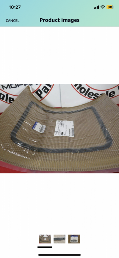

Does this gasket seem to be the right one for the 68rfe it doesn’t look like the same shape as the lube locker one. Edit: that is an oil pan gasket I found the trans pan gasket on racing summit site

Your filters look correct but that gasket is not. This is the one I ordered.
FEL-PRO TOS 18733 Automatic Transmission Gasket https://a.co/d/a5arVtN
You need 68425659AA Genuine Mopar 68RFE transmission rubber coated metal pan gasket... Check with Benny from All Mopar Parts : https://www.ramforum.com/forums/all-mopar-parts.133/ he is a preferred vender here on Ram Forum and he sells Mopar parts at discount
