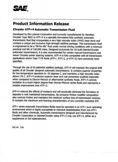

Mopar ATF+4 is likely just a standard Group III quasi-syntheric with requisite +4 friction modifier additives. That has moderate oxidation life.
Red Line +C ATF and Amsoil MVATF are true Group IV & V synthetic oils the provide maximum oxidation life.
This is critical if you haven't removed the trans oil cooler thermostat.

Without being able to lay my hands on the ATF+4 specification sheet, I can probably estimate that ATF+4 uses a Group III base stock, if nothing more because of the original release date of the product.
However, I do not believe that the base stock is the critical element. The additive package which has been developed around the clutch materials and engagement strategy is still a proprietary compound (recipe) even though there are now a couple of companies currently licensed to produce the fluid.
(see attachment)
Regards,
Dusty

They're both critical in transmissions.
Base oil stability under heat is critical to preventing varnishing of servo valves and clutch facea.
