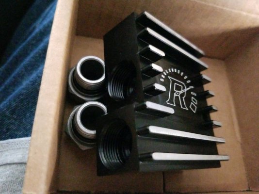

I have been searching for the bypass valve for my 2018 2500 6.4 with a 6 speed, but the only ones I find indicates for diesel applications. How hard was the install? I haven't messed with transmissions in many years, with the install is there a bleeding requirement like doing brakes? Like I said, last work was a mid-80s standard that I replaced the clutch and before that an automatic in a Chevy.

RFE's are straight forward. They're all the same. The bypass is nothing but an aluminum block with thru passages and connector ends.
There are tips and tricks, though. I wrote up my experience somewhere. The block is in the oil lines to and from the oil cooler radiator - it's not in the transmission.RevMax Transmission Cooler ByPass Housing Installed - Copy.jpegRevMax Transmission Thermostat Housing Replacement - Copy.jpeg
