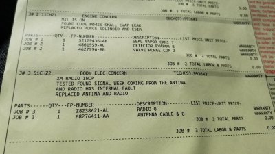

Finally back in my own wheels. And, Mopar approved for that dealer to fix everything, so I will not have to make yet another trip to fix the radio. Kind of funny that the service person that called me from Ancira said "and we were able to get it all covered under the factory warranty so we didn't have to use your extended warranty." Well that's awful kind considering I brought it in with 34K miles on it...
Side note, Ancira found out that South Point had actually broke the new radio they (south point )put in my truck a couple weeks ago. So, Ancira had to put a 3rd radio in my truck. South Point is WAY off my list of future service locations now.
@ramcares (Jasmine ) Thanks for all your help getting this pushed through!
