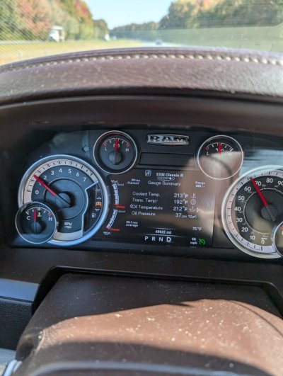

Temp looks normal, I agree oil temp looks a little high. Here is a pic from my 2014 8 speed (i have the 3.6) but ambient temp was also 75.
Well, all those might be normal, but IMHO, they are on the hot side compared to my 2017 8 speed (I the have the 5.7 HEMI) and the outside ambient temp was 79°.
