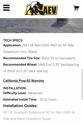

This is from their website.
top picture if from the air rise lift page, bottom picture if from the spring ride lift page. Both lifts use the same knuckles and front end parts with only the air ride struts being the difference.
Yea I saw those too. “Recommended” vs won’t fit is different. I’m feel like they will say no. However BDS says no too and I’ve seen a few Rebels with their lift on stock wheels too. So I just would like to know. I really don’t mind the Rebel wheels. So having to replace them isn’t something I’m crazy about. Plus I like all the sidewall on 35s when on 17s.

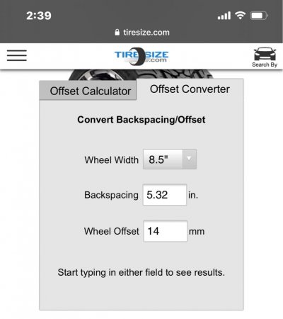

This is going to be a long post. By no means I am trying to argue. Just want to lay out some “math”.
So their site does recommend 18x8.5 with 5.32 backspaceaf6b92524345386b5a7fda2cf45e16ec.jpg

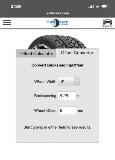

Or 20x9 with 5.25” BS:

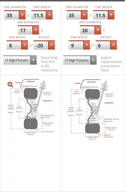

Now my Rebel wheels with the 1.5” spacer is equivalent to 17x8 with -20 offset (1.5” is 38mm so that’s how I got to -20). Using the info above here is my Rebel wheels with spacers vs AEV recommended 18s63c602d62e8bf05c7ee3a26b6daadae5.jpg
Now here would be my Rebel wheels with spacers vs the AEV recommended 20s
Here is another visual for my 17s with spacers vs the 18 set up AEV recommends:
(The AEV set up is closer to suspension components)
Here is a visual showing my Rebel wheels with spacer vs the recommended AEV 20” set up
(Again AEV set up is closer to suspension components)
Just for another reference here is a conversion chart for backspace to offset:
Now I’ve never had a full lift kit so maybe I’m not accounting for something. But when I do all of this math and look at it on my own I don’t understand why my 17” OEM Rebel wheels with spacers making them essentially 17x8 -20 couldn’t work...
