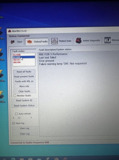

Same exact problem with mine. 4 fobs all fail after 1 single drive.
I got these codes in Rf hub, and after clearing them they wouldn’t show again until I hit a fob button again. And new code for each new fob I tried.
This last time I sat in truck a bit and all my dash finally shut down. I tried new fob again just for giggles and my gauges lit back up after pressing fob button.
It’s weird. Exactly as others said, worked perfectly programming and I kept checking it as I was home over the next couple hours and kept hearing horn beep when I locked doors. First drive to grocery store, wouldn’t lock or do anything after I shut it down when I got there.
(My other codes for ECM/PCM and TCM went away and stayed away after clearing. I just did a cam/lifter swap, and then a bad battery just after lol. So a lot was unhooked during that, I think they were from then)

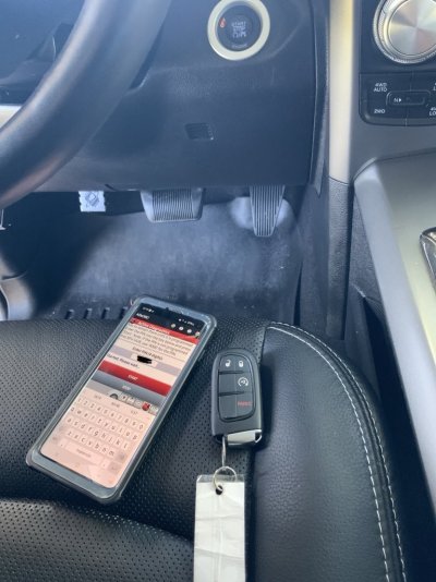

My problem is my aphaobd app does not complete the programming of an Amazon “OEM” 4 button fob for my 2014 RAM 1500 Sport (with push to start ignition) when interfacing with ObdLink. Based on ObdLink chatter on the 2 inside indicator lights, communication with hub appears normal, but I am wondering if hub is talking to the key fob. How could that be tested? New battery, btw.
