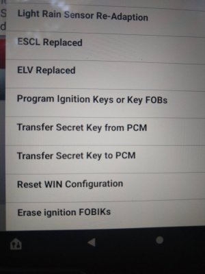

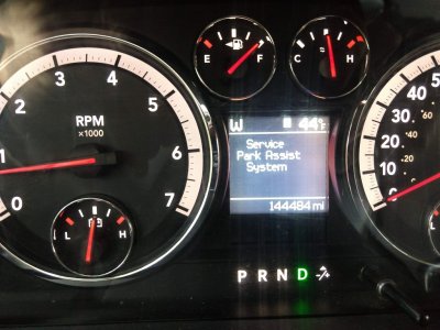

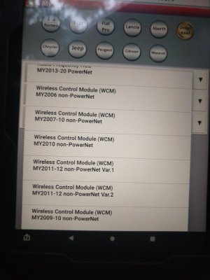

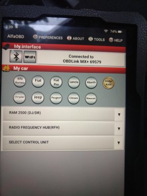

I hope someone can help me. I keep getting this message
The message will clear when I use the back up then pops back up after driving forward for a few minutes.

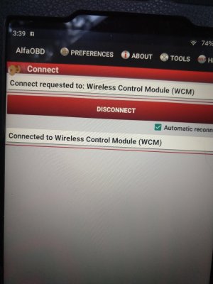

I use the following to connect and try to clear the message for good, but it isn't working. What am I doing wrong? Wrong module, wrong action?
I have connected to both WCM seperately. More pictures to follow

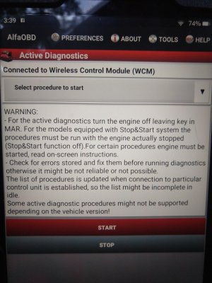

Rustyraindog
Nov 15, 2020
86
123
Spanaway, WA
2011 PW

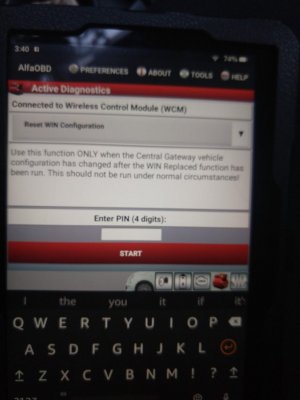

Here I chose reset WIN config and the following message pops up. I ran it anyway after getting my PIN with pinpuller, but it did not fix the message Service Park Assist System. This is on my 2011 and I am not sure where to go from here?6th.jpg

Turns out I was connecting to the wrong module. I need the parking module. Looks like a have some faults that keep coming back.

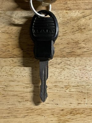

can you help me? I have a 2012 2500 with Cummins diesel. I was only given the key. No fob.
I want keyless entry. I have power windows and power locks.
this is my only key.
