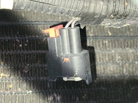

Got two two fobs working today.
Remote start and hood lamp are my next challenge as well. Rather than make it unsafe with just a resister, my plan is to add the hood latch with the hood down sensor in it. Would hate to be working on something under the hood and accidentally remote start the truck with my hands in there.
I found that my truck is wired for remote start. Plug behind the grill, just hanging there is to plug into the latch I am ordering.
Hoping that is all I need to add it.
Also, Will find wiring harness and pigtail for the under hood light at the junk yard tomorrow.
