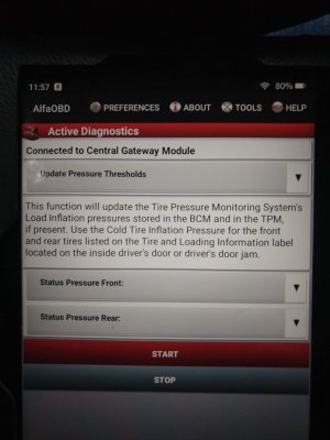

Is this the correct field to rest the threshold for the TPMS lower? I want to set my tires at 45PSI and don't want the low tire pressure warning on the dash.IMG_20210124_115704065.jpg
aimvee
Apr 28, 2019
84
16
CA
Is this the correct field to rest the threshold for the TPMS lower? I want to set my tires at 45PSI and don't want the low tire pressure warning on the dash.View attachment 235150
Yes, that's it.
Set it, than drive it.
IF, that's does complete it.
Connect to "WCM" under the RF-HUB and "Reset WIN configuration".
You'll need your 4 digit code for this.
Either go to dealer. Or get it from "Chrysler pin puller". It's 15 tokens to get your PIN number. And first time using the app you get free 15 tokens so it won't cost you anything
