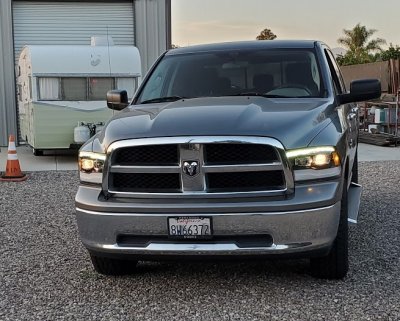

I'm trying to get the DRLs to work on my 2009 1500 SLT. I changed from the stock dual headlights to Alpharex first generation lights. I used Alfaobd to set the lights to quad and that worked. And after reading every post in this thread related to the DRLs I first set it to Canadian DRL and to use the highbeams. I then followed another post where it said to enable the DRLs in the main menu and then under reconfigurable options to set it to DRL Optional. Still nothing. And yes, I check with the parking brake off and in drive. The DRLs on the top of the headlights are just wired to the TIPM to come on with the key.
Has anyone gotten a 2009 to have the DRLs working? This is a US truck.
On my 2012, I put it in R, N or D with parking brake off, but the motor must be running (not just ignition on). I used the Canada option. I did not set the DRLs in the main menu.
They don't come on under any conditions.

You need the headlights off when you check as well. If the main lights come on, server you have set to DRL goes off. I had mine in my 11 2500 set to turn signals but ultimately turned them off completely

I normally have the lights on auto but have tried with the lights off as well.

In the body module there is a Daytime Running Light option i think you need to enable. This option is in the active diagnostic section rather than the car configuration change section.

I did that and it didn't help.
