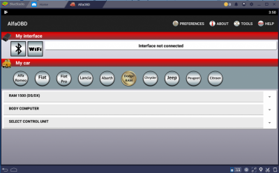

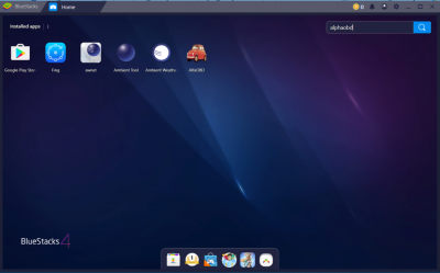

Based on reading all through this: Android vs PC seems to be a personal preference?
I have an amazon Fire and a Windows Tablet (Microsoft Surface)....so I'm debating on if I should get the Android or PC version. Both are very portable and have WiFi for when I get the OBDLink MX and security cable.
Is it only personal preference then?
So if you like to use android, but want a larger screen such as a laptop, you can download software called BlueStacks4 and it works as an android interface on a windows computer. https://www.bluestacks.com
