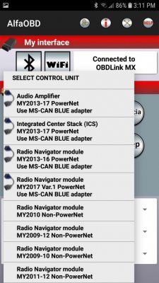

Does anyone know for a Ram Rebel what my car option selection should be in regards to my model. REBEL is not listed. Would it be OFF ROAD?
Michael Dent
Jan 27, 2019
29
Greensboro, Georgia
2916
His a log file as I changed it without noting what my factory choice was: Learning the hard way.
Car configuration change: Special Package: 'SPORT/SLT+/LARAMIE ' -> '16 '
Car configuration change: Special Package: 'LIMITED ' -> '23 '
Car configuration change: Special Package: 'RAM 1500 ' -> '18 '
Car configuration change: Special Package: 'OFF ROAD TRUCK ' -> '23 '
Car configuration change: Special Package: 'RAM 1500 ' -> '12 '
Car configuration change: Special Package: 'PREMIUM (DEFAULT), OR SXT OR R/T OR LARMIE ' -> '18 '
Car configuration change: Special Package: 'LIMITED ' -> '5 '
Car configuration change: Surround Sound Present: ' NO ' -> '1 '
Car configuration change: Special Package: 'MOPAR/SPORT ' -> '18 '
Wondering if my factory setup was 'SPORT/SLT+/LARAMIE ' -> '16 '
My problem:
I need help.
I have a 2016 Ram Rebel with the 8.4 radio RA3 which NAV was added.
Somehow in using the AlphaOBD I suspect I changed a setting on the radio unit and now the XM and the SD card reader do not show up plus the radio fm and am does not work at all. NO tuning or sound evident.
Bluetooth is working and music will play.
Does anyone know what the ALPHAOBD setting should be?

I currently don't have a Rebel in the shared BCM configs. Did you link your Google Drive account and create/upload a log before any changes were made? If so, you can PM me your original config. Make a new connection to your BCM/Read System ID then upload another and I will try to help you out.

The Special Package settings usually just changes the logo on the EVIC, but that Surround Sound setting is a radio setting.
I believe the normal Special Package setting for a Rebel is the Off Road Truck one. That one causes the EVIc to display the Rebel logo.

Do you know what would change the radio hardware setup causing the SD card to not be seen. It is as if my 2016 Rebel is seeing the radio as 2017 radio when the SD card was removed.
While connected to the body Computer check to see if you have any faults. Probably nothing will show up but worth a shot.
I just went through all the choices in the body Computer and didn't see anything that jumped out at me that could be changed that would have an effect on losing xm/SD button and sound for fm. A couple other things you can try is disconnecting you battery for a while and resetting the radio.

Here is the file log
I'll take a look. You can in the mean time look under ..
ECU Configuration 3:
External Port Type: AUX + USB (My settings) Yours would be the one with SD
