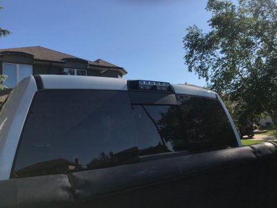

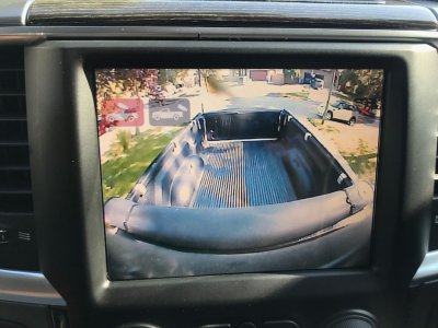

I have purchased and installed the Mopar LED CHMSL with cargo camera.
The only item in the menu that I have seen for the Cargo Camera is the button in the controls to turn the cargo camera on and then toggle back and forth from the backup camera to the cargo camera.
CHMSL camera: Set
CHMSL line customer setting menu: Not set
LED CHMSL Lamp Present: Set
CHMSL Lamp Open Circuit DTC Enable: Not set
CHMSL Lamp Output Disable: Not set
I tried to enable the CHMSL line customer setting menu but did NOT see any change or extra setting in the menu, so I decided to disable the setting.
CHMSL camera: Set

I enabled the "CHMSL line customer setting menu" and went for a ride.
Did a soft reboot on the radio and the setting is there.
Problem: when I select the setting the check box will "uncheck" itself after a few seconds.
I connected the Power and Lin Bus as DeereGuy had posted to connect the cargo camera.
https://www.ramforum.com/threads/installing-oem-backup-cam.53505/page-102#post-1404552
"After a few hours of looking at schematics I came across connector I440 that is located in the "C" pilllar on the drivers side right above the seat belt. Low and behold it had both the F923 power and Lin Bus CBC3 in it and better yet they were not pinned coming out the other side of the connector."
Connector I440 was already pinned in my truck...
May have to look at schematics again later
